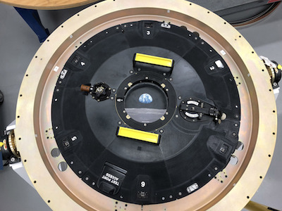

Lockheed Martin is one of the first customers leveraging Stratasys' Antero material - a PEKK-based thermoplastic with advanced mechanical, chemical and thermal properties. (Photo: Business Wire)
The Orion spacecraft leverages a variant of new Stratasys Antero 800NA to build an intricately-connected 3D printed docking hatch door. (Photo: Business Wire)

The Lockheed Martin, Stratasys and PADT-engineered collaboration is differentiated by an ability to create consistency and repeatability in mass scale across the entire additive manufacturing part production process. Lockheed Martin is also one of the first customers leveraging Stratasys’ Antero, using the new thermoplastic for a critical part situated just outside of Orion’s docking hatch. The complex part consists of six individual 3D printed components locked together to form a ring on the craft’s exterior. The part is currently on display in the Lockheed Martin booth #603 at the 34th Space Symposium in Colorado Springs, CO April 16-19. PADT is also at the event, joining Stratasys at booth #537
