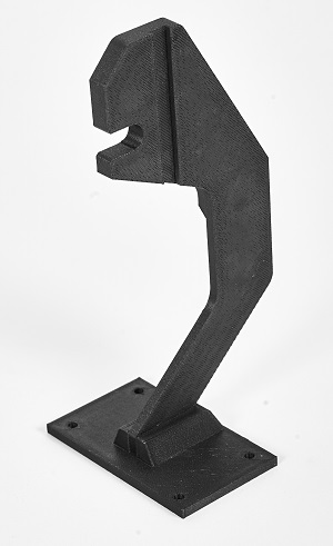

Based in Rotterdam, The Chocolate Factory runs a network of packaging machines, with the company’s daily throughput relying on the smooth operation of a simple, yet crucial, hook-shaped metal part that lifts wrapped bars onto a conveyer belt. A problem occurs when the part malfunctions – typically with such regularity that it necessitates replacement three times a month. As each replacement part is handmade, delivery can take over a month.
3D printed replacement machine part, produced in tough Stratasys FDM Nylon 12CF thermoplastic containing 35% chopped carbon-fiber (Photo: Business Wire)

Van de Rijzen uses Stratasys’ high-performance FDM Nylon 12CF composite material, a carbon-filled thermoplastic containing 35% chopped carbon-fiber. Produced on the Stratasys Fortus 450mc Production 3D Printer, the 3D printed replacement machine part is currently being used at the factory. According to van de Rijzen, the team at The Chocolate Factory are impressed with the high stiffness-to-weight ratio of the FDM Nylon 12CF, resulting in parts of extreme rigidity.
“The success of the 3D printed part was instantly clear – the material is impossible to bend,” says van de Rijzen. “The part withstood all tests on the machine and multiple runs were completed without incident. The factory is now enjoying increased production throughput by replacing the metal machined part with our 3D printed version.”
Previously, constant human intervention meant that the functionality of the metal part suffered and the machine was often damaged. “Now, with the ability to optimize the design of the part with the Fortus 450mc, this has improved due to the part being much lighter than its metal counterpart,” continues van de Rijzen. “The Chocolate Factory is also enjoying significant economic benefits too, with the team reporting a 60% cost reduction on the part.”
