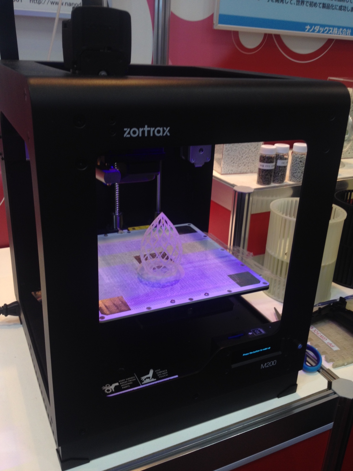

3D printing with crystalline PP resin enabled via glass wool reinforcement.
According to company chairman Masanori Fujita, the reinforcement serves to reduce mold shrinkage for the crystalline resin from 1.5% down to the order of 0.5%, which is on a par or superior when compared to traditional 3D printing resins such as acrylonitrile-butadiene-styrene (ABS), whose typical shrinkage is 0.7–0.9%.
At the Plastic Japan show held this week in Tokyo, Nanodax was demonstrating application of its 3D G-magic Filament using a standard 3D printer (M200 desktop single extruder 3D printer from Polish company Zortrax. The PP base material was supplied by Sumitomo Chemical. Recommended nozzle temperature is 220–270°C.
