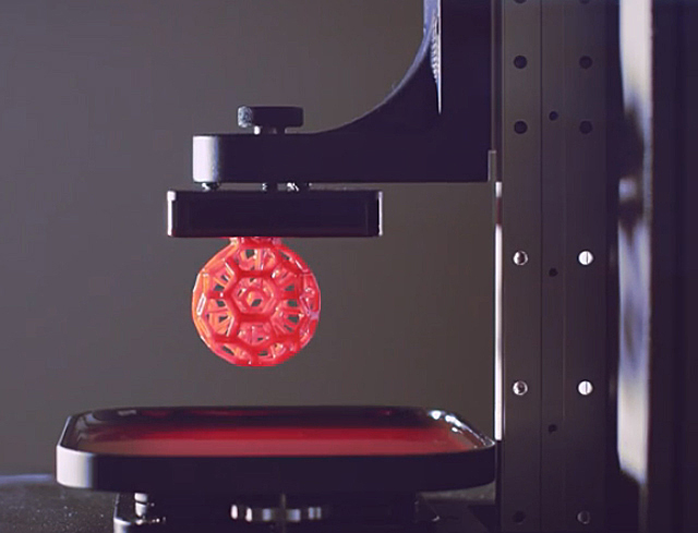

Continuous Liquid Interface Production (CLIP) technology uses finely tuned light and oxygen to continuously grow objects from a pool of resin, rather than creating them layer by layer, as conventional 3D printing does. Carbon3D CEO and co-founder Joseph DeSimone demonstrated the machine at this week's TED (Technology, Entertainment and Design) conference in Vancouver, BC, Canada, where it printed a plastic ball from a pool of resin in 10 minutes, reports BBC News. "It would traditionally take up to 10 hours to print this," DeSimone told the audience. "There are mushrooms that grow faster than some 3D-printed parts," he joked. A paper on the technology was published simultaneously in Science on March 16, 2015.
By carefully balancing the interaction of UV light, which hardens the resin, and oxygen, which inhibits hardening, CLIP technology rapidly transforms 3D models into physical objects. These are not prototype parts: Commercial-quality objects are produced with consistent mechanical results from a range of polymeric materials, says the company. And it does that in a fraction of the time of conventional 3D printing. Currently, Carbon3D estimates that it accelerates printing by 25 to 100 times, and it has the potential to be 1000 times faster.
