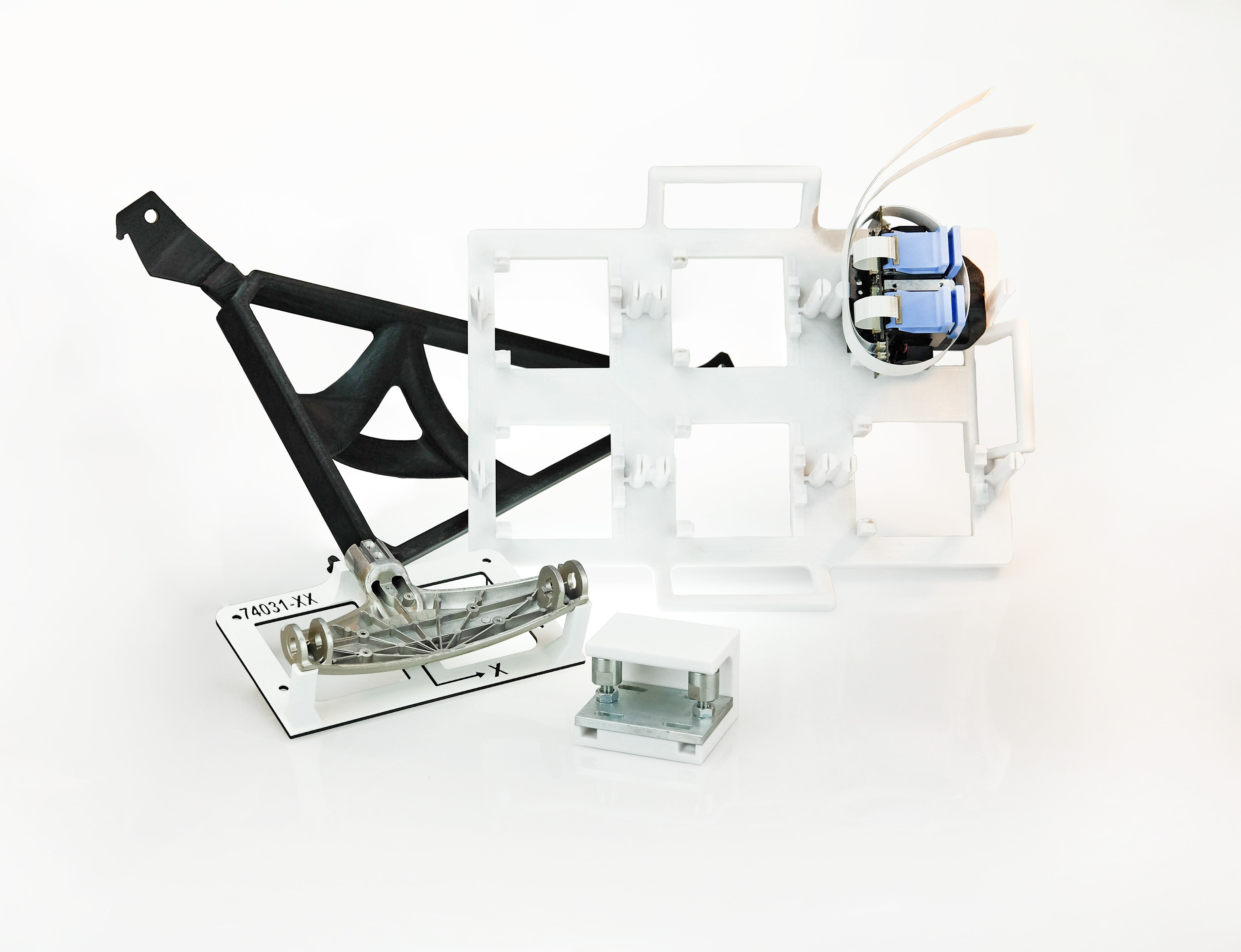

3D-printed custom manufacturing tools, like jigs and fixtures, is one example of how additive manufacturing is being used to augment conventional production environments. Now, Stratasys’ Manufacturing Aids Package offers assistance to manufacturers seeking to create custom manufacturing tools. The materials-and-services package includes 40 hours of design work from Stratasys Professional Services to make producing a first tool easy.

“3D printing jigs and fixtures enables manufacturers to improve these tools’ usability and ensure their availability,” says Stratasys Sr. Director, Product Management and Marketing, Sanja Wallace. “The ability to design a manufacturing aid specifically for a given task and produce it on demand is a huge benefit. And producing these tools from lightweight thermoplastics instead of metal makes them much easier to use and more cost-effective to produce.”
