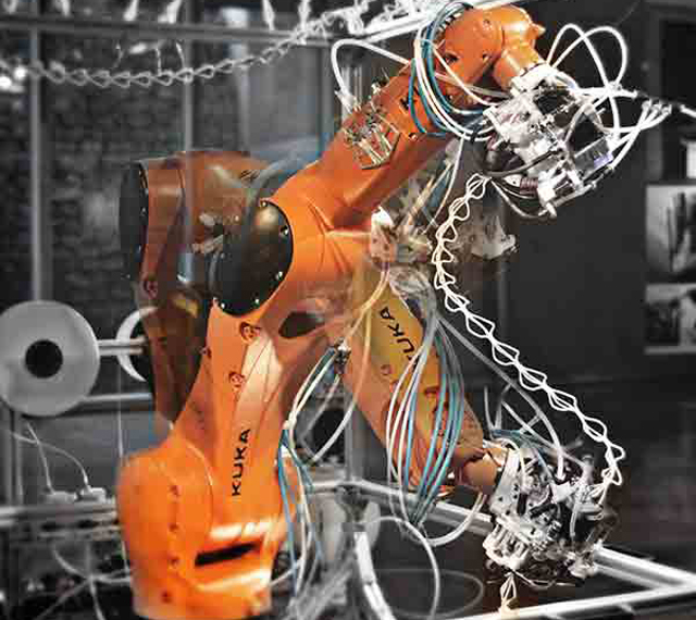

kuka-robot-350.jpgKey to the extrusion process is a Kuka six-axis robot with end effectors to which three mobile print heads are attached arrayed around a fourth fixed print head. Each print head incorporates a heater that maintains a precise temperature to permit extrusion of the ABS/PLA material. As the material strands exit the print head, they are blasted with compressed air so that they harden.
The four material delivery systems are driven by individual servo motors, explains Shi on the Behance website, and an additional motor rotates the central turn-plate. Printing and rotation speeds can be adjusted to achieve specific structures.
