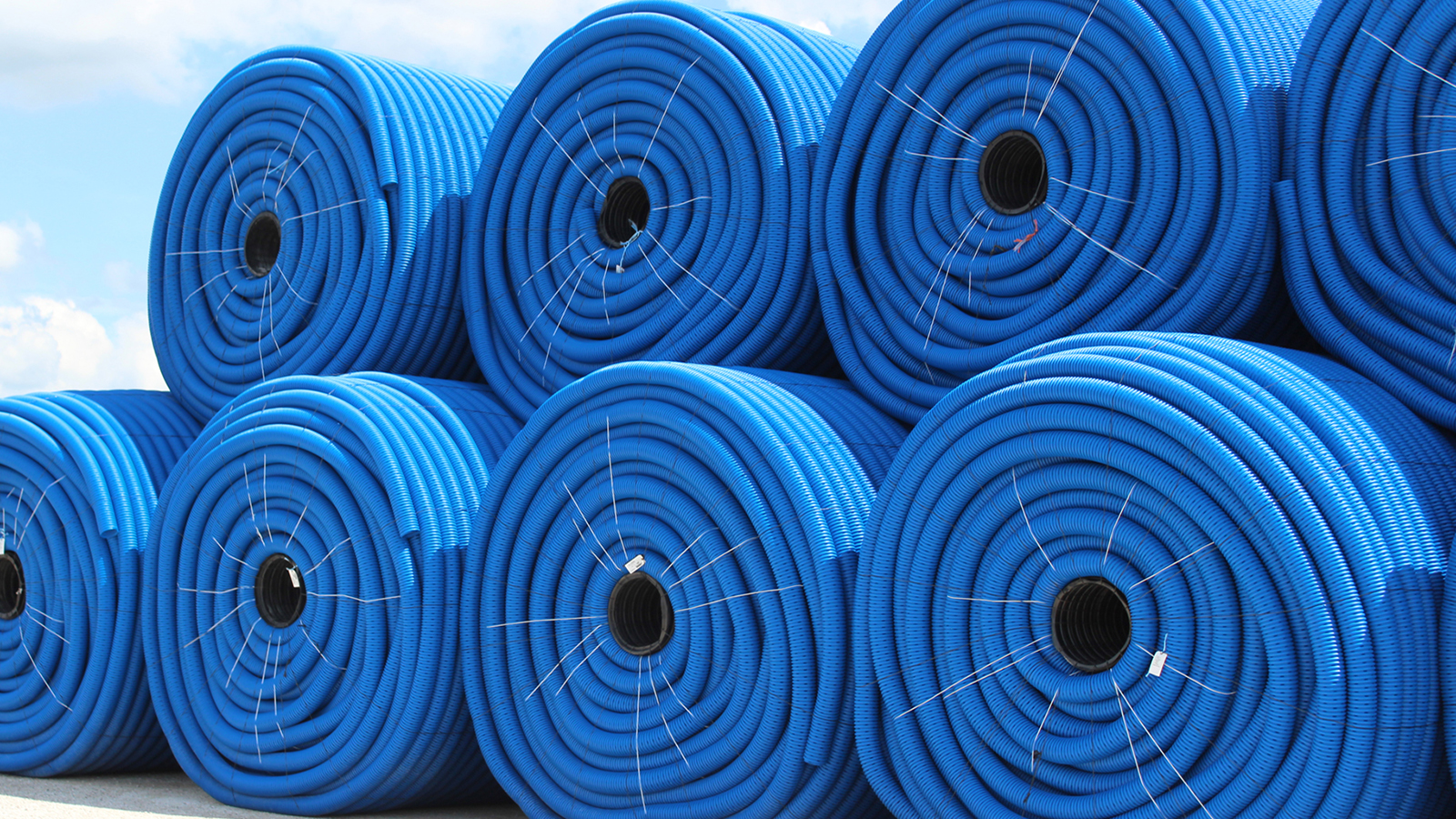

Extruded blue pipes
Image courtesy of Timewell/GreenMantra
Specialty additives by Canada’s GreenMantra Technologies helped an Illinois high-density polyethylene (HDPE) pipe manufacturer incorporate a broader range of recycled content and increase production speed by 25% — a success spotlighted at NPE2024 in Orlando.
Timewell Drainage Products, which incorporates post-consumer (PCR) and post-industrial (PIR) waste into its stormwater and agricultural pipes, used GreenMantra’s Ceranovus PN to improve processing. GreenMantra’s additives are made from waste plastic using its patented molecular recycling method.
