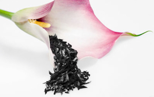

Image courtesy CFK Valley Stade Recycling.
