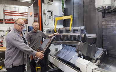

Rapid Granulator (Bredaryd, Sweden) is making a major investment in machining equipment at its headquarters in Bredaryd, Sweden. Installation of three high-precision, highly automated machining centers, with a total investment of €4.5 million, will provide the company with extra capacity to produce core components to very tight tolerances while improving overall process flow.
Because the “Done-in-One” machine can perform both turning and milling, Rapid can produce major components like rotors in a single step. Before, this was a job that required several separate setups.
A new “Done-in-One” turning and milling machine was installed in April, followed by a horizontal machining center in June; a third machine is scheduled to go into operation before the end of the year. The machining centers are fully integrated with an FMS (flexible manufacturing system) center, involving automatic rail-guided vehicles that have the capability of running without any operator intervention.

Rimark highlights the outstanding capability of the new equipment. The two very large horizontal machining centers each hold over 200 different tools and can carry out a wide range of tasks, including grinding, drilling and threading. “This provides us with 100% control over all tolerances,” he points out.
