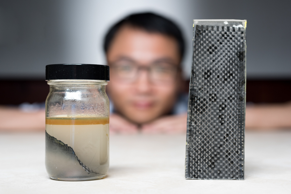

Researchers at Georgia Institute of Technology have developed a method to recycle nearly 100 percent of the materials in certain types of thermoset carbon fiber composites. The new method involves soaking the composites in an alcohol solvent, which slowly dissolves the epoxy that binds and gives shape to the carbon fibers. Once dissolved, the carbon fibers and the epoxy can be separated and used in new applications.

The research team focused on carbon fiber that uses a special type of epoxy called vitrimer epoxy to give the composite component its shape. “Vitrimers contain dynamic bonds that can alternate their structure without losing network integrity under certain conditions,” Yu said. “We let alcohol, which has small molecules, to participate in the network of alternating reactions, which effectively dissolved the vitrimer.”
