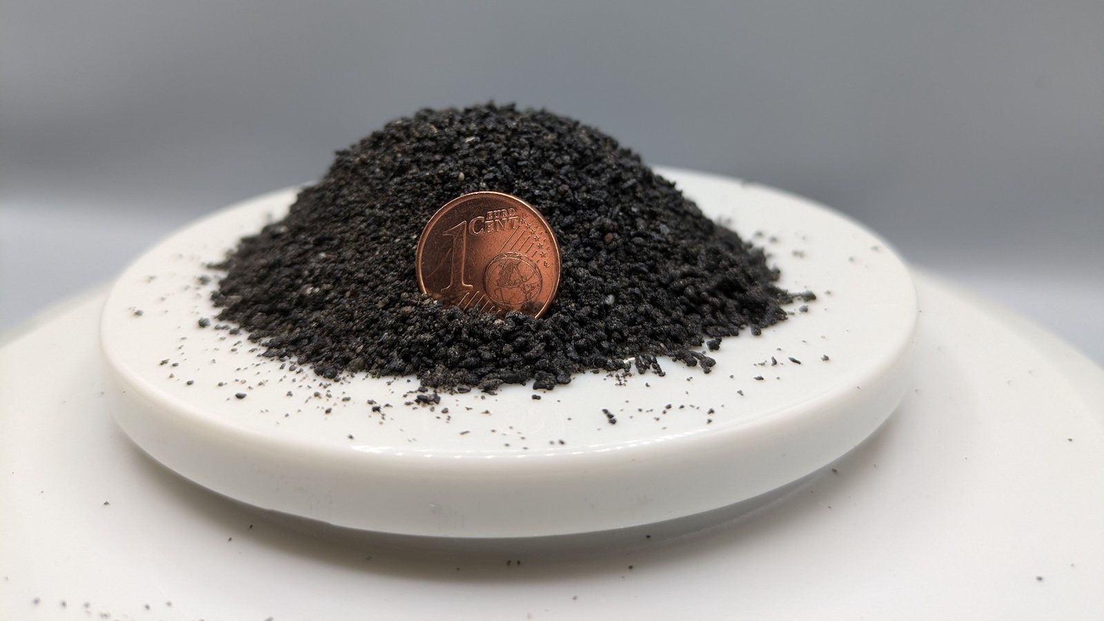

pile of tire-abrasion particles with euro coin for scale
Rubber abrasion at a typical tire-wear rate of 30 g per 100 km is pictured. Scientists are investigating the factors that cause and influence this phenomenon.Image courtesy of Martin Gießler, Karlsruhe Institute of Technology
