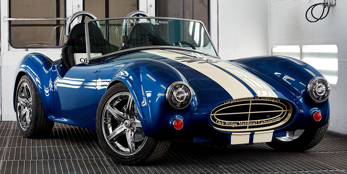

This Shelby Cobra sports car, 3D-printed at Department of Energy's Manufacturing Demonstration Facility at Oak Ridge National Laboratory, was on display at the Detroit Auto Show Technology Showcase.
Researchers printed the Shelby car at DOE's Manufacturing Demonstration Facility at ORNL using the Big Area Additive Manufacturing (BAAM) machine, which can manufacture strong, lightweight composite parts in sizes greater than one cubic meter. The approximately 1400-lb. vehicle contains 500 lb. of printed parts made of 20 percent carbon fiber reinforced composite.
The team took six weeks to design, manufacture and assemble the Shelby, including 24 hours of print time. The new BAAM system, jointly developed by ORNL and Cincinnati Incorporated (Harrison, OH), can reportedly print components 500 to 1000 times faster than today's industrial additive machines. ORNL researchers say the speed of next-generation additive manufacturing offers new opportunities for the automotive industry, especially in prototyping vehicles.
Recent improvements to ORNL's BAAM machine include a smaller print bead size, resulting in a smoother surface finish on the printed pieces. Subsequent work by TruDesign (Knoxville, TN) produced a Class A automotive finish on the completed Shelby.
