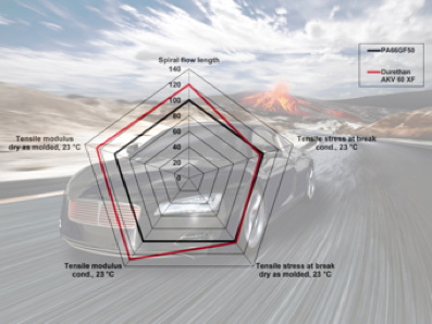

Despite very high loadings of 60-percent glass fiber, new grades of polyamide (PA) 66 from Lanxess retain high flowability, while also boasting chemical resistance and extremely high strength and stiffness.
60% glass fiber reinforced PA 66 compound outperforms equivalent PA 6 compound, with excellent processability to boot.
Existing PA 6 grades Durethan BKV 60 EF and XF are being joined by the new PA 66, which is to be marketed under the name Durethan AKV 60 XF. “The material exhibits excellent strength and stiffness. It unlocks a whole new dimension of design freedom for all-plastic parts, plastic/metal hybrid technology and continuous-fiber-reinforced semi-finished thermoplastic composites. What’s more, it can be used as a metal substitute in a whole range of applications,” says Ralf Heinen, a plastics expert at Lanxess.
At 13,300 MPa (conditioned, room temperature), the material’s modulus of elasticity – an indicator of stiffness – is more than double that of the standard polyamide 66, Durethan AKV 30 H2.0, which has a glass fiber content of 30 percent. As Heinen says: “Our innovative material gives users the opportunity to produce parts that have thinner walls than alternatives made from polyamide 66 with 30 percent glass fiber reinforcement but exhibit similar mechanical performance. Thinner walls offer an additional potential of being able to save weight.”
As can be anticipated, compared to its PA 6 with the same glass fiber content, the new highly filled PA 66 structural material offers better resistance to chemicals, while its temperature of deflection under load (ISO 75-1,-2), at 250°C, is almost 40°C higher. “Moreover, at 180°C, the maximum long-term service temperature is some 40°C higher than for polyamide 66 grades with standard heat stabilizer. This exceptionally high thermal stability is a very special feature of the material that significantly expands its range of applications,” explains Heinen.
Another advantage of the new material is its excellent processing characteristics. Despite the high glass fiber content, it exhibits the same flowability as PA 66 with a 35 percent glass fiber content. It can also be injection molded at the same temperatures. Depending on component geometry, mold cooling and processing conditions, components can often be demolded earlier, because the compound is stiff enough even at high temperatures and also conducts heat better. The thinner walls that can be achieved thanks to the improved material stiffness also help to cut cooling times. “Both can significantly reduce cycle times and help deliver a more cost-effective manufacturing process,” explains Heinen. Despite the high filler content, the resultant components exhibit smooth surfaces, with virtually no protruding fibers. This can be attributed to the excellent flowability of the melt and optimized crystallization behavior.
