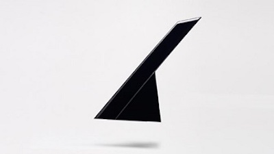

Piano black surface finish coupled with scratch resistance achievable with new AMSAN copolymer grade.
