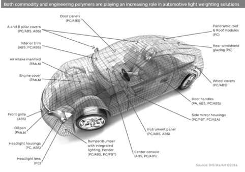

Driven by increasingly stringent government regulations to meet fuel efficiency standards and reduce carbon emissions, by 2020, the average car will incorporate nearly 350 kilograms of plastics, up from 200 kilograms in 2014, according to chemical researchers at IHS Markit (London).
More plastics on the way in autos
In the US, for example, the Corporate Average Fuel Efficiency (CAFE) standards mandate that carmakers’ passenger vehicle fleets average 54.5 miles per gallon by 2025, and according to estimates from IHS Markit, fuel economy must be improved by approximately 50 percent across the passenger vehicle fleet. Increasingly, automakers are employing newer-generation plastics and plastics composites to meet those newer efficiency standards, according to IHS Markit.
For the most part, mainstream automakers are initially employing traditional metalworking approaches to weight reduction, as these offer a cost-effective application of known competencies, secure supply chains and most importantly, existing capital equipment. However, said IHS Markit, automakers are increasingly employing more novel approaches, such as adopting more plastics and next-generation composites into automotive design, particularly for larger vehicle applications.
“While metal and metal alloys are still critical to automotive design, automakers are finding innovative ways to leverage plastics and composites into their designs to help reduce vehicle weight and improve efficiency,” said Casey Selecman, senior manager of automotive advisory services at IHS Markit. “As efficiency and carbon reduction regulations increase globally, we at IHS Markit expect the use of plastics will only increase as the materials improve and production costs are reduced.”

The uses for these materials range from electronic components, through to body panels, lift-gates, seatbacks, center consoles, interior trim, and even underhood applications. The plastics consumed for automotive manufacturing are often compounded with fiberglass and additives to improve mechanical properties and stability.
