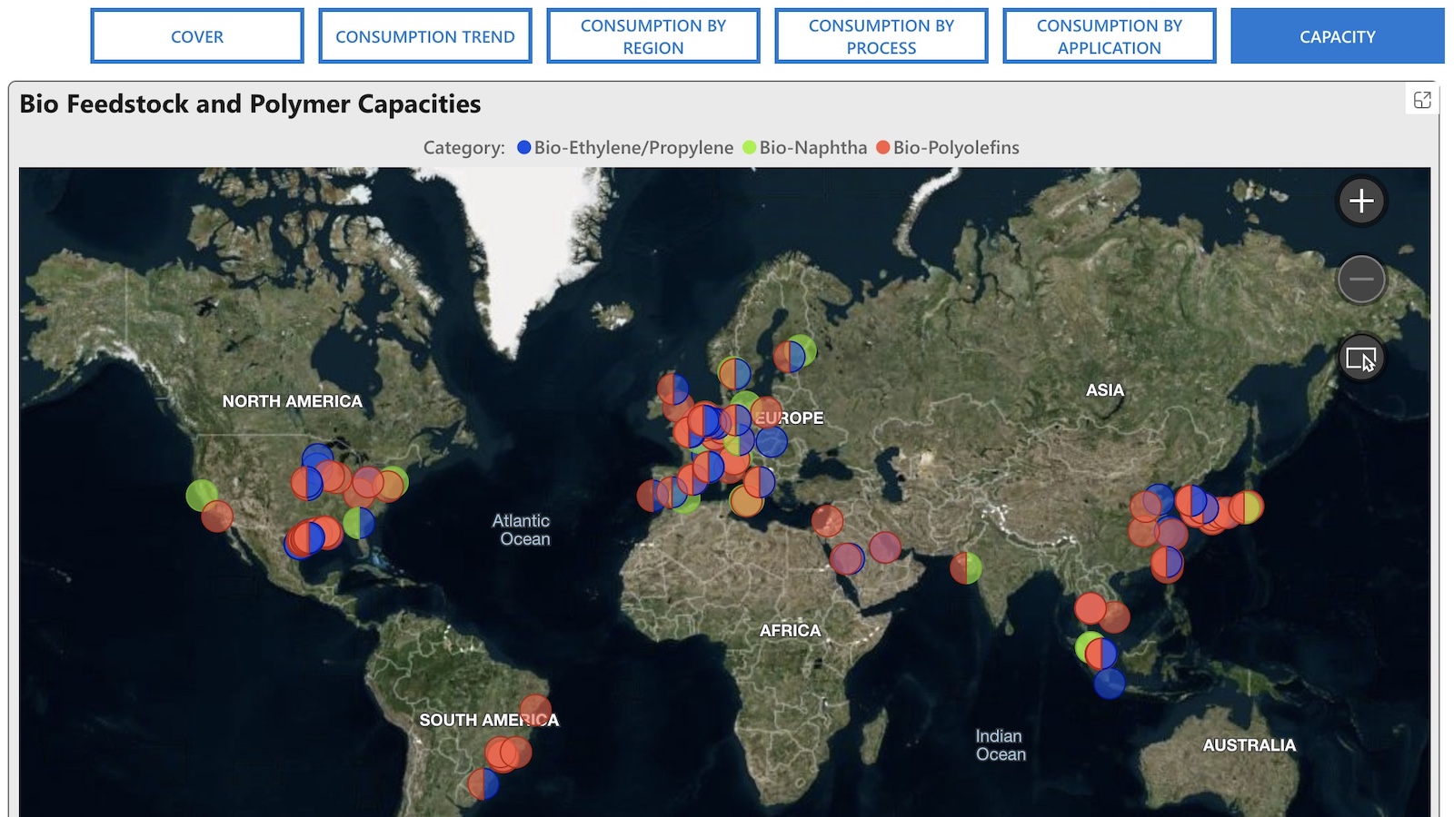

Chart showing bio feedstock and polymer capacity by continent
Widespread availability of bio-based PP and PE resins will be one factor driving increased uptake of sustainable materials in mobility and other applications.Image courtesy of MLT Analytics
