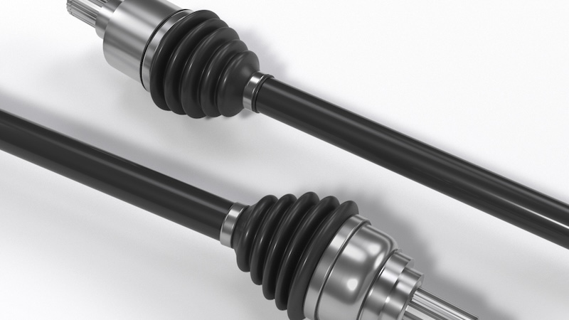

CVJ boots
Image courtesy of Celanese.
Celanese has expanded its portfolio of materials for automotive boots and bellows. New solutions include multiple sustainable materials and a new grade suitable for injection molding these parts.

Hytrel TPC LCF thermoplastic elastomer delivers the thermo-mechanical performance, flex fatigue, and processing ease of Hytrel TPC, but reduces a part’s carbon footprint by more than 50% compared to traditional CR neoprene rubber and up to 40% compared with other TPC materials. It also offers a broad service temperature range from -40° to 130°C and features a 40 Shore D hardness.

In addition to these materials, Celanese is also introducing Hytrel TPC HTR8745LV, developed specifically for injection molding of compact boots mounted on the rear half-shaft drivetrain of vehicles. Injection molding opens more design options for these parts and enables lightweighting and optimized productivity with multicavity tools.
Polymer scientists at Celanese developed a formulation that combines the melt flow (LV = low viscosity) required for injection molding with the flex fatigue required by the application. Other grades for CVJ (constant velocity joint) and diaphragm boots require high viscosity to meet the applications’ requirement for flex fatigue resistance. High-viscosity materials process well with press blow molding, the normal process for manufacturing these applications, but would hinder injection molding throughput.
