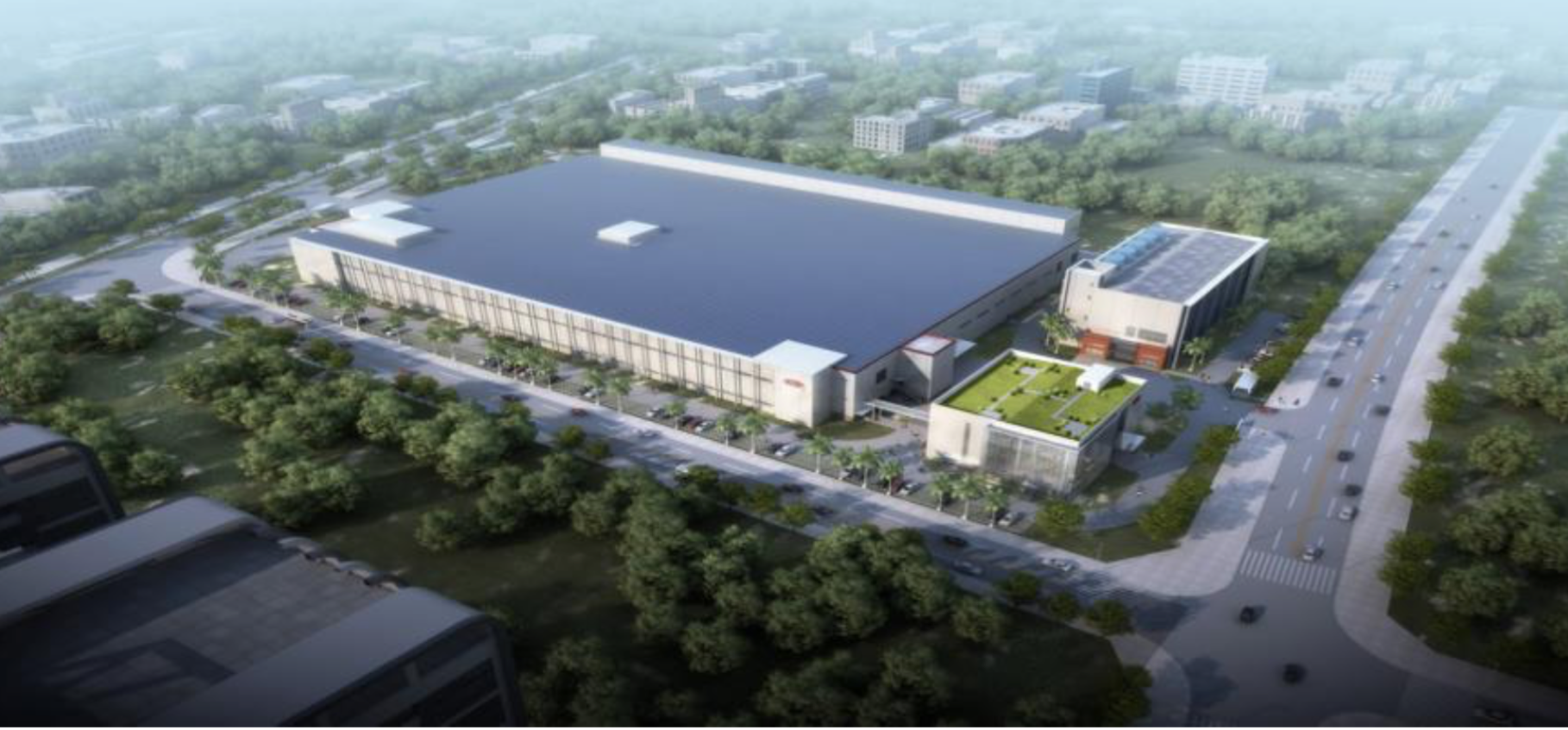

DuPont is in the process of relocating its China engineering plastics compounding plant from its current site in Shenzhen to a new facility located in the Guangming New District, also located in Shenzhen, Guangdong Province. The compounding facility will be DuPont’s largest globally, with scope for further expansion to boot, although DuPont declined to provide details of capacity. The plant is due to be inaugurated within the next three months.
DuPont’s Hanck: Expecting strong demand growth for engineering plastics in auto under-the-hood and metal replacement applications.
Apollo: DuPont’s massive new compounding facility will launch production operations in Shenzhenlater this year.
The site will compound Zytel polyamides, Crastin polybutylene terephthalate (PBT), Delrin polyacetal (POM), Bynel anhydride-modified linear low-density polyethylene (LLDPE) adhesive resins, and Fusabond maleic anhydride grafted polypropylene (PP) resins commonly used as coupling agents, among others.
