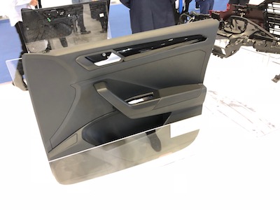

A 5% talc-filled polypropylene (PP) grade from Borouge exhibits good flow properties and heat resistance, boast low VOC emissions, and is needless to say lighter in weight than conventional 15–16% talc-filled PP compounds with similar stiffness. Daplen EF011AC has also been engineered to exhibit minimal shrinkage.
VW Touareg door panel employs 5% talc-filled grade for reduced weight with stiffness retention.
Ivan Xu, Vice President, Marketing Centre Mobility at Borouge says that the compound is already being used in the VW Touareg manufactured in China in a door panel weighing in at 1 kg, or 10% lighter than a door panel molded from a 15–16% talc-filled PP compound.
