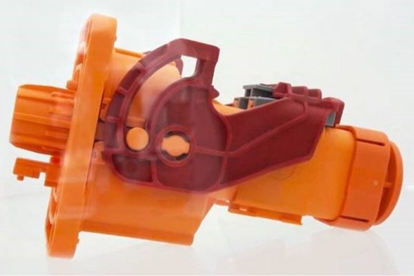

Solvay Performance Polyamides’ Technyl e-range focuses on surging demand for materials capable of handling the cost/performance challenges of automotive electrical and electronic components, including signal orange colored grades for high-voltage applications such as connectors, circuit breakers, sensors and insulators in the growing market segment of e-mobility.

“We have also developed a range of highly stable Technyl orange colored grades as we continue to innovate our portfolio for e-driven vehicle applications,” adds Batailley. “Orange is the new black for ease of identification as we focus on components designed to handle high voltages, such as connectors, circuit breakers and insulators.”
