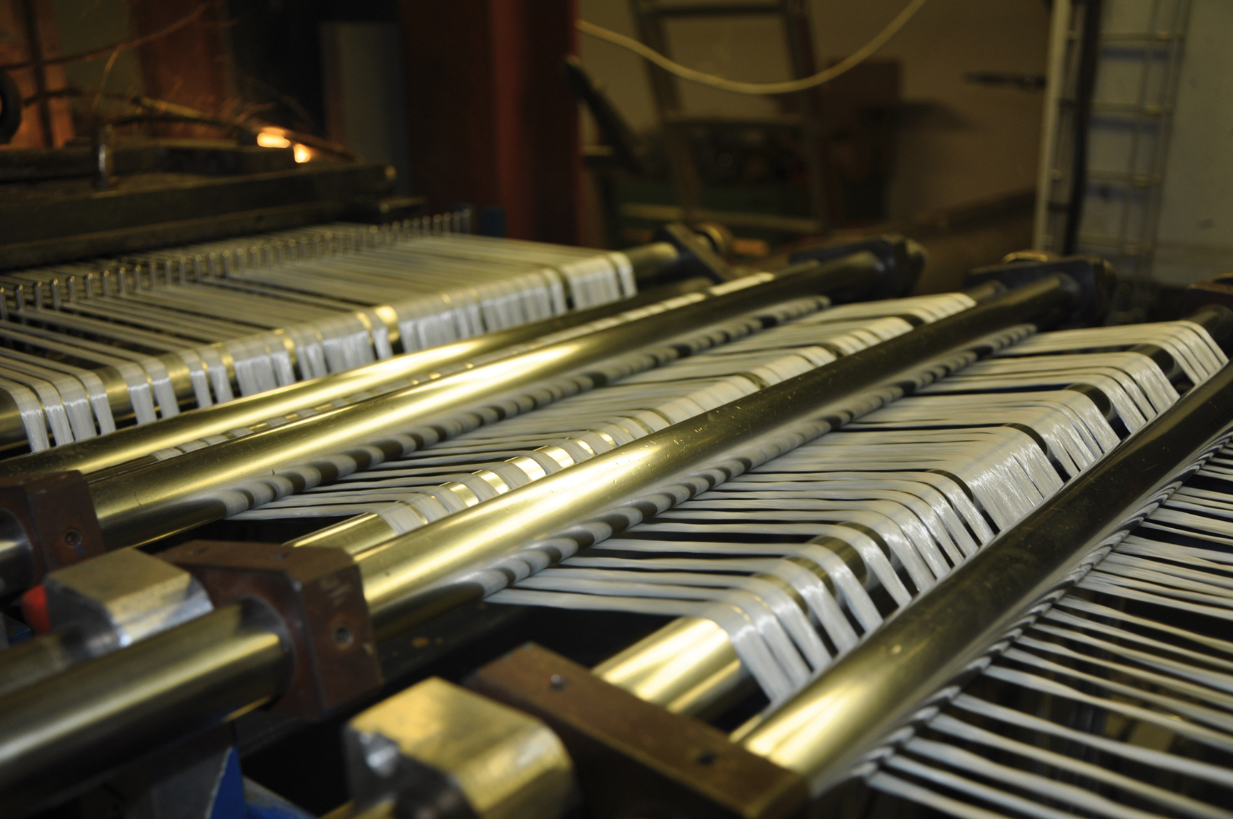

Roving pre-warming with spreading of the individual fibers enables the best individual fiber wetting. (Photo: ProTec Polymer Processing)

Moreover, roving unwinding with rotating coils, as well as roving pre-warming with individual fiber spreading, enable the best possible fiber impregnation. The complete installation offers one further advantage: different polymers in combination with special additives can be used in the same production line. Support and development of customer-specific formulations can take place in ProTec's Testing Center in Bensheim.
