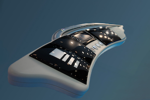

Covestro constructed and first used a “demonstrator” electronic display at the K 2016 plastics trade fair in Düsseldorf, Germany. The company again plans to demonstrate its film solutions at other events in Germany, notably the Folien + Fahrzeug conference (Feb. 8 and 9, 2017, in Bad Kissingen) and the VDI Plastics in Automotive Engineering conference on March 29 and 30 in Mannheim.

Another application for polycarbonate films integrated into the demonstrator are switches with “flying symbols.” These center on an innovative combination of printed films and cutting-edge injection molding techniques, creating switches with a kind of optical 3D effect. During production, several layers of Makrofol DE films are printed with various symbols. Their bottom layer has a patterned reverse side. The top layer consists of a particularly scratch-resistant film. Covestro explained that when a switch is printed with this film structure, various three dimensional images of the pattern on the reverse side appear, depending on whether the LED lighting comes from the side or from below.
