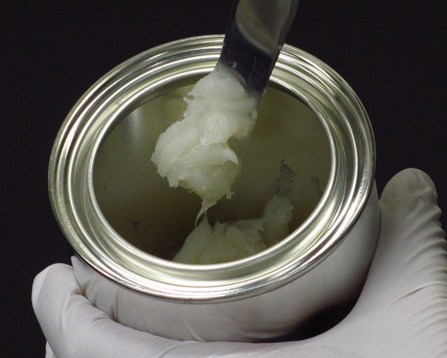

Japan’s DIC has developed a masterbatch called Epiclon NCM consisting of 10 wt% cellulose nanofiber (CNF) dispersed in an epoxy carrier. Addition of the masterbatch to epoxy resin reportedly improves the traditional disadvantages of epoxy resins, namely their brittleness and lack of toughness.
Cellulose nanofiber masterbatch prevents crack propagation in epoxy thermoset composites.
