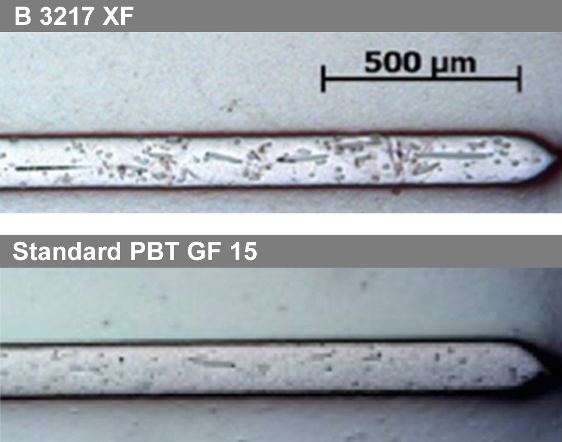

In new PBT grade, glass fibers are much more evenly distributed in narrow cavities than when using standard grades on account of vastly improved fill behavior, particularly at low wall thicknesses.

One example of a non-reinforced PBT compound is Pocan B 1205 XF. Thanks to its outstanding flowability, this material is perfect for the trend toward miniaturization in the electrical engineering and electronics sectors. It is ideal for complex components with exceptionally thin wall thicknesses, such as mini plugs. When thin wall thicknesses of such components have to be combined with high mechanical stability, Pocan B 3217 XF is the material of choice. Neuwald adds: “This reinforced PBT with 16 percent glass fibers features a vastly improved fill behavior, particularly at low wall thicknesses. The glass fibers are therefore much more evenly distributed in narrow cavities than when using standard grades, which gives the component excellent mechanical stability.”
