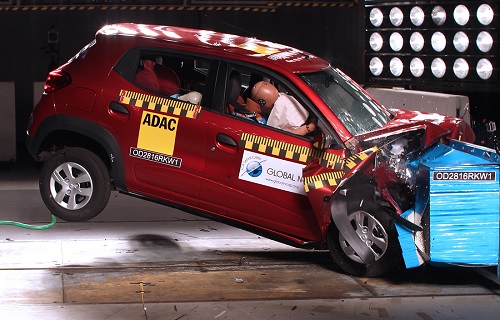

Automakers have also been criticized in India for substandard safety features. Results for India’s ‘car of the year,’ the Renault Kwid, surprised and disappointed Global NCAP. After poor results earlier this year, and following Renault’s latest set of improvements, the Kwid was assessed again in the frontal impact test and the model still offers just one star for adult occupant protection.
In its standard version, the Renault Kwid is offered without airbags and has been tested by Global NCAP in the past. The basic version of the car scored zero stars for adult occupant protection and two stars for child occupant protection. The latest version and the most highly equipped safety levels, includes an airbag only for the driver and a seatbelt pretensioner for the driver’s seat. During the test this version still showed high chest deflection, explaining the one star rating in the driver seat.
