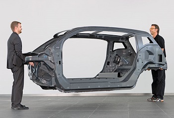

Those familiar with the i3 electric vehicle from BMW may also be aware of the extensive use of carbon-fiber composites to realize lightweighting. They may not be so up to speed on one of the key processes employed to mold the passenger compartment and other components: High-pressure resin transfer molding, or HP-RTM.

The HP in HP-RTM refers to the elevated pressure, in general around 120 bar, at which the typically epoxy resin-based system is formulated at the mixing head with catalyst and mold release agent to form a homogenous system for injection into the mold. The tool contains a draped woven or non-crimpled carbon fiber fabric as the reinforcing material. This processing approach allows industrially viable cycle times of around five minutes to be realized versus several hours to several days for standard RTM processes for fabricating large components such as aircraft frames and wind turbine blades. “We have already achieved two-minute cycle times in development, and a bit above a minute for simple parts using a polyurethane system,” notes Henning. “And new generation materials are about to be introduced which will achieve one-minute cycles.”
According to Henning, in platforms developed from the ground up such as the BMW i3 and i8, use of composites can save up to 50% in weight for the vehicle as a whole, whereas for lightweighting existing designs such as the BMW 8 series, where a steel-composite hybrid approach is adopted, the weight savings are of the order of 20-40%.
