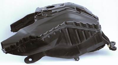

A highlight of Lanxess’s presentation will be the tank of a BMW Motorrad road machine, which is made from Durethan BC550Z 900116 DUSXBL. The unreinforced and impact-resistant modified polyamide 6 is injection-molded into two half-shells, which are welded to the tank by means of hot plate welding. Thanks to this material, the engines can be manufactured cost-effectively in large quantities despite their complex geometries. The limit values for fuel emissions through the tank walls are undershot by a considerable margin.

BMW Motorrad motorcycle fuel tank is injection-molded from impact-resistant modified polyamide 6. Image courtesy of Lanxess.
