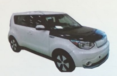

A Hyundai prototype electric vehicle was the test bed for a carbon fiber composite hood.
The carbon fiber-reinforced hood was 2-3 kg lighter than an aluminum hood, and 7-9 kg (63%) lighter than a steel hood, and also allowed a lower center of gravity to be achieved and a better distribution of weight between the front and the rear.
