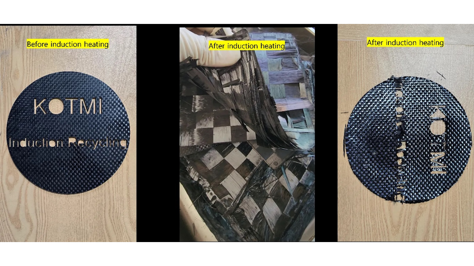

Induction heating represents a low-cost, low-energy-intensity route to CFRP recycling. Image courtesy of Ilsung Composites

The partners’ novel induction heating (IH)–based pyrolysis technology efficiently recycles CFRP composites while preserving the fiber aspect ratio. The process utilizes high-frequency magnetic fields to generate rapid, localized heating in carbon fibers, thereby facilitating efficient polymer matrix incineration.
