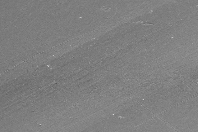

Additive confers scratch resistance (above) to polypropylene and TPO grades used in auto interiors. The photo below shows an unmodified compound.
