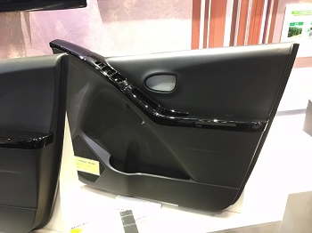

Foamed door trim employing the hybrid additive is less likely to cause injury to vehicle occupants if a collision occurs.

Addition of the new additive to PP increases Charpy impact strength substantially without sacrificing rigidity to any great extent. The additive is particularly effective at inhibiting sharp edge fracturing in vehicle collisions for components such as foamed door trim, which is 30% lighter than conventional materials.
