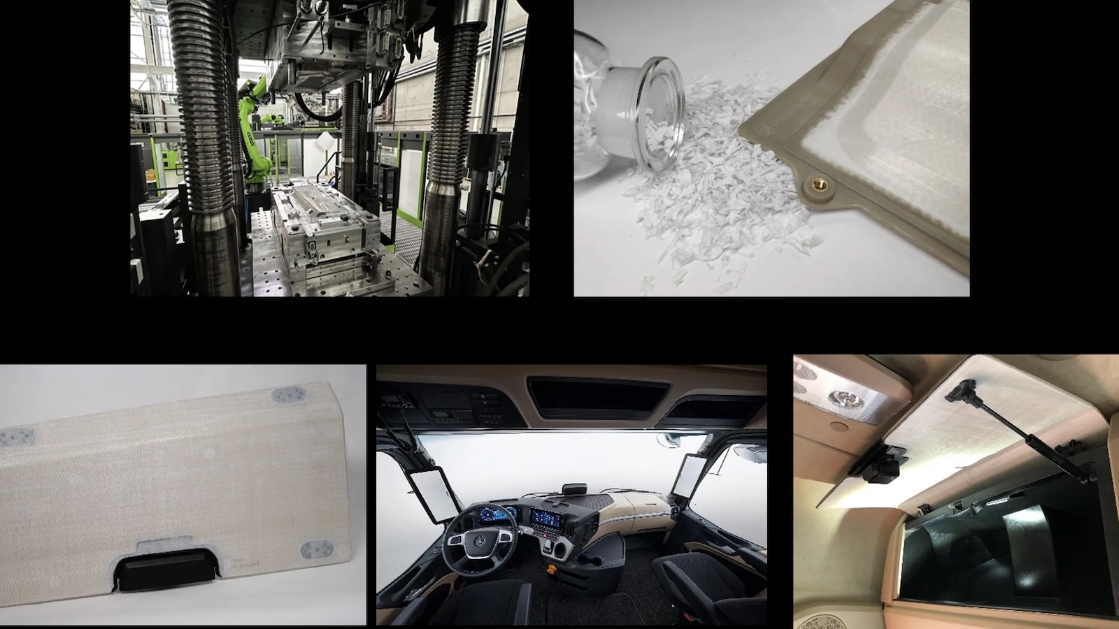

Thermoplastic sandwich molding technology that enables the fully automated production of 3D-molded components in a lightweight construction was developed by Fraunhofer IMWS in collaboration with partner companies.Image courtesy of Fraunhofer IMWS
A new thermoplastic sandwich molding technology enables the fully automated production of 3D-molded components in a material-efficient lightweight sandwich construction. The potential of this innovative hybrid technology was demonstrated using a storage compartment cover from a truck driver's cab.
The technology was developed by German research organization Fraunhofer IMWS with fellow German companies Daimler Truck, ElringKlinger, ThermHex Waben, and edevis GmbH, and Austrian injection molding machine maker Engel. It recently won a JEC Composites Innovation Award in the automotive category.
Compartment cover prototypes prove technology's viability
The commercial-scale production of functionalized, 3D-molded lightweight sandwich components was successfully demonstrated by the partners in a collaborative R&D project. Prototypes of the storage compartment cover proved the viability of the  thermoplastic sandwich molding technology for an actual component structure. The 3D shaping of the part is realized by thermoforming of a semifinished thermoplastic sandwich panel in a closed tool, which also enables additional functionalization by injection molding for integration of hinges and fasteners.
Key benefits include a light and stable sandwich construction, reduced material usage, efficient processability suitable for large-scale production, integral design and functional integration, and recyclability thanks to the use of thermoplastics.
