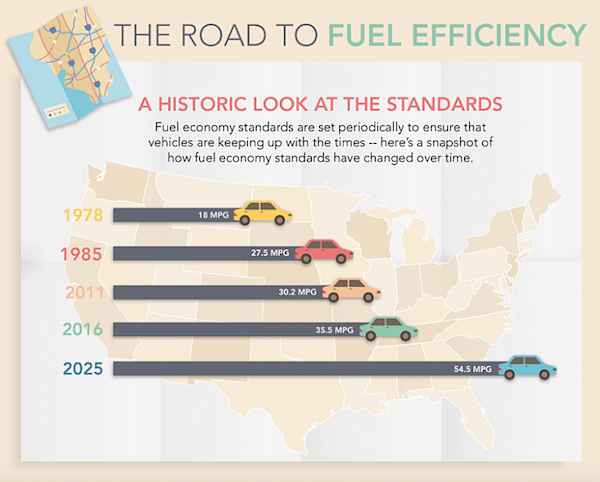

Automotive OEMs know the mandated goals for the Corporate Average Fuel Efficiency (CAFE) standards: 38.6 mpg by next year and 54.5 by 2025. According to David Trudel-Boucher of the Advanced Polymer Composites group of the National Research Council Canada, OEMs want low-cost solutions in short cycle times. Yet, the “automotive industry needs to adopt processes that meet the realities of today’s requirements,” said Trudel-Boucher, who presented a plenary lecture, “Advanced Polymer Composite Manufacturing Processes for Automotive Applications,” at the Plastics-In-Motion conference in Charleston, SC, which ran from May 8 to 11.
