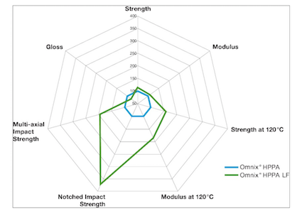

Notched impact strength is markedly improved in LFT grade.

When comparing the properties of standard reinforced Omnix products, the ductility of Omnix LF grades shows up to 350 percent higher notched and multi-axial impact strength while preserving material stiffness. Such gains would be impossible to achieve with conventional impact modified compounds, where the elastomeric nature of the impact modifier generally decreases the stiffness of the material.
Omnix LF grades also exhibit high property retention under the influence of heat and moisture. When compared with standard glass filled HPPA, the LFT technology offers a stiffness improvement of 10 to 15 percent at 23°C (73°F), which rises to 85 percent at 120°C (248°F), far beyond the glass transition temperature of the matrix resin.
