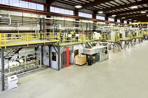

Oak Ridge National Laboratory researchers at the Carbon Fiber Technology Facility have demonstrated a production method that dramatically reduces the cost and energy required to produce carbon fiber.
The new process can produce carbon fiber at a much higher throughput than is possible with conventional methods.
