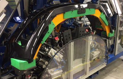

Tier 1 parts supplier Magna has put a new twist on joining thermoplastic materials to help automakers cut weight and costs: torsional welding. The torsional welding process, developed by Magna for automotive applications at its exteriors plant in Liberec, Czech Republic, presents a new way to join plastics. It features a high-speed twisting motion that creates enough friction-based heat to join a plastic bracket to a thermoplastic fascia.
Magna’s torsional welding process is used to make the front fascia of the 2017 Skoda Octavia. It has potential for other applications where materials of similar composition need to be joined.
The technology achieves an approximate 10 percent weight reduction because it allows thinner materials to be joined, which in turn reduces material costs. Torsional welding is currently used to make the front fascia of the 2017 Skoda Octavia, and it has potential for other applications where materials of similar composition need to be joined.
There may also be uses for torsional welding with the increase of advanced driver assistance systems and the development of self-driving cars. The trend will be for automotive fascias to become heavier with the increase in autonomous features, due to the addition of sensors. With torsional welding, it's now possible to reduce weight on the outer skin and brackets so more sensors can be added without impacting the overall weight of the vehicle.

The torsional welding process is used to make the front fascia of the 2017 Skoda Octavia. It has potential for other applications where materials of similar composition need to be joined.
