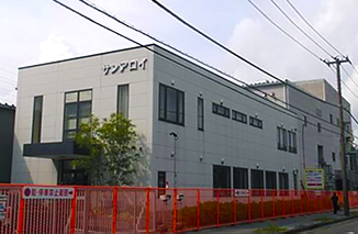

Japanese resin supplier Mitsui Chemicals is expanding capacity to satisfy demand for Milastomer, a vulcanized thermoplastic elastomer (TPV) known for its low density, softness and processability. Construction work for 5000 tonnes/yr of additional capacity will commence in February 2017 at wholly owned subsidiary Sun Alloys Co., Ltd. and conclude in June 2017, with commercial operation start-up slated for October 2017. Currently Sun Alloys has overall compounding capacity of 60,0000 tonnes/yr for Milastomer and other Mitsui Chemicals products.
Mitsui Chemicals is expanding TPV capacity in Japan to cope with increased demand from auto application such as weather strips.
