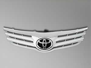

New plating grades include a high-heat
version based on ABS/PC.
