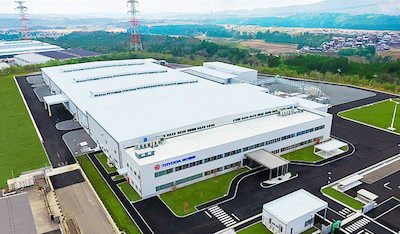

Japanese Tier 1 parts maker Toyoda Gosei Co., Ltd. has established a new plant in the city of Inabe, Mie Prefecture, Japan to produce high-pressure hydrogen tanks, a crucial component of fuel cell vehicles (FCVs). Preparations for the start of production are currently underway.
