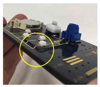

Sensors employed in automobiles are a prime target for a new laser direct structuring PS grade from Japan’s DIC.
Prior to July last year, liquid crystal polymer (LCP), polyamide (PA), and polyetheretherketone (PEEK) were among the engineering plastics approved by LPKF for its LDS process. Several companies were also known to be working on PPS grades for approval but DIC is the first to be officially certified as a PPS grade supplier for the process. Currently, DIC is shipping samples of the compound, which incorporates an organic metal compound dispersed throughout the PPS matrix.
