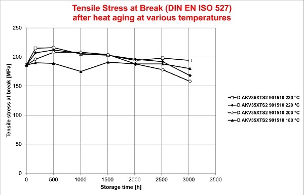

Lanxess has developed a new heat stabilization system called XTS2 (Xtreme Temperature Stabilization) for polyamide 66 variants of its Durethan materials. This system increases the heat aging durability of the polyamides so much that they reach into the heat deflection temperature range.
Even after 3,000 hours of storage at 230°C, the reduction in tensile stress at break and elastic modulus is barely measurable in Durethan XTS2.

Lanxess extensively tested the high long-term temperature resistance of the new polyamide 66 by conducting hot air aging tests. “Even after 3,000 hours of storage at 230°C, the reduction in tensile stress at break and elastic modulus is barely measurable, meaning the material maintains its initial strength and stiffness despite the high thermal load,” says Linder. The material was mainly designed for high-tech engine applications that are exposed to unusually high temperatures – such as air intake manifolds with integrated charge air coolers or air pipes located near the turbocharger.
