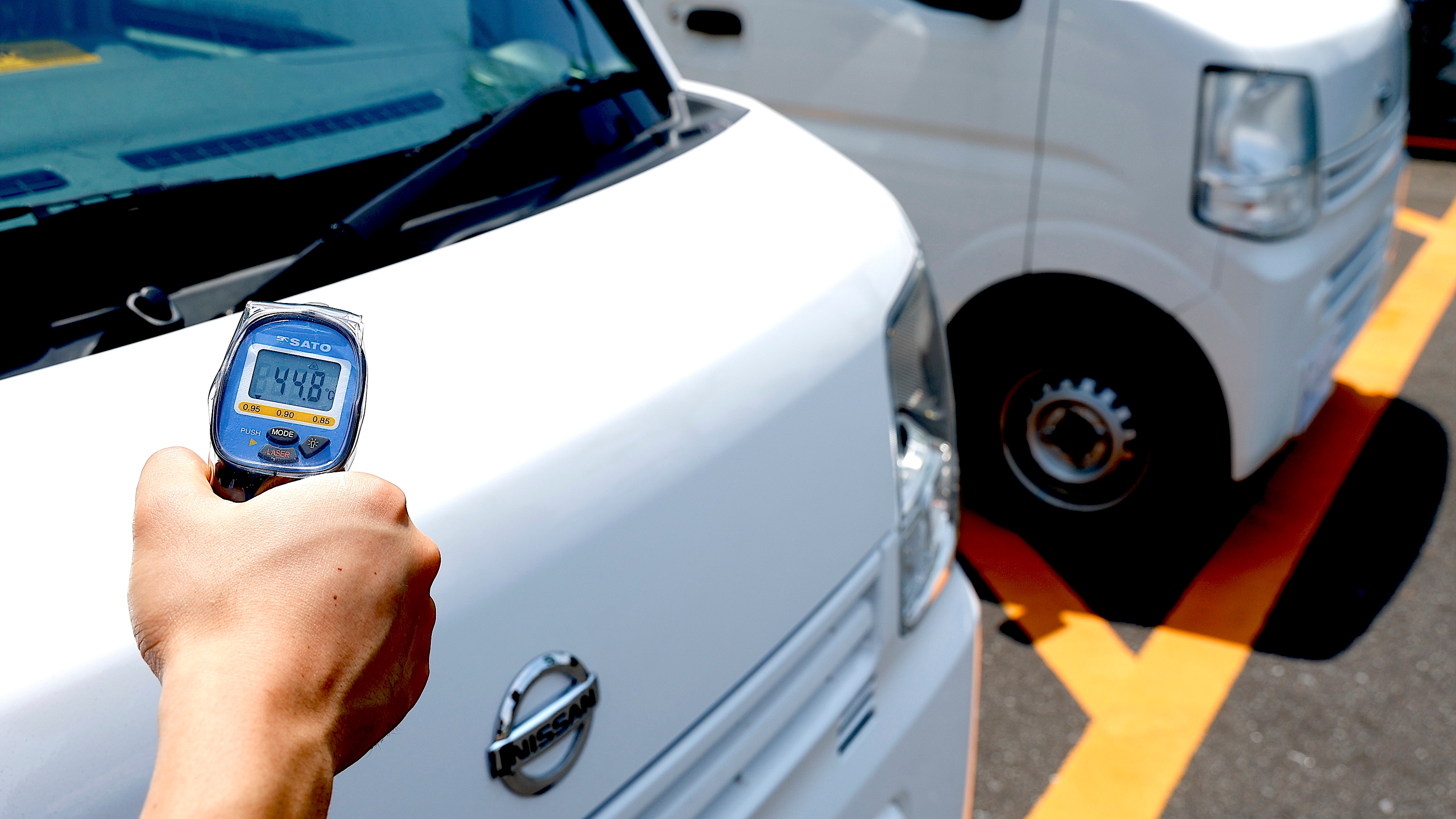

The pyrometer shows the temperature of the NV200 van's hood while baking in the sun.
The pyrometer shows the temperature of the NV200 van's hood while baking in the sun.Nissan

Parked side-by-side under the sun, a vehicle treated in Nissan's cool paint has shown yields of up to a 21.6-degree Fahrenheit reduction in exterior surface temperatures and up to 9-degree Fahrenheit cooler interior, compared to a vehicle featuring traditional automotive paint.
