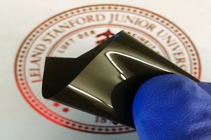

Bunched together, as shown here, nanoparticles of graphene-coated nickel conduct electricity. When the battery overheats, the particles separate and electric current stops flowing. During cooling, the particles reunite and the battery starts producing electricity again.
The thin polyethylene film is embedded with spiky nanoparticles of graphene-coated nickel.
