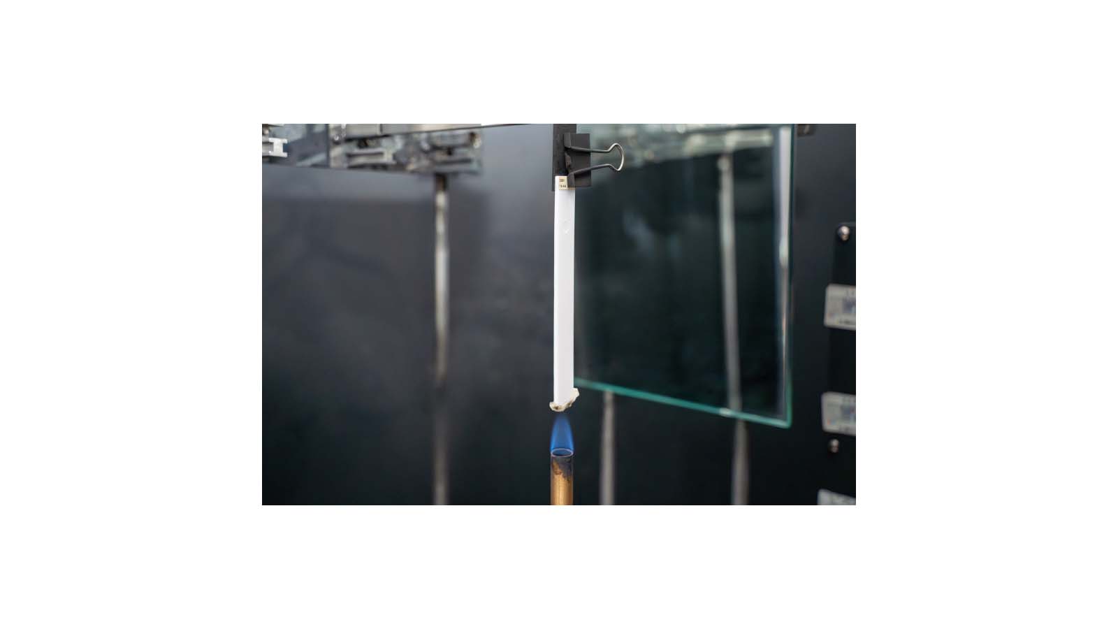

UL 94 flame-retardance test
LG Chem
South Korea’s LG Chem reports that it has developed a PFAS-free flame-retardant polycarbonate (PC) and acrylonitrile-butadiene-styrene (ABS) blend made largely from recycled materials.
The combination of PC and ABS significantly enhances heat and abrasion resistance, said LG Chem, and the material has received the V0 rating in the standard UL 94 flame-retardant test for certification in the United States.
The V0 rating is the highest level of flame-retardant performance in the industry, meaning the material will extinguish within 10 seconds when a flame is applied vertically. LG Chem said it is the first company to certify a V0 level or higher flame-retardant performance with a PFAS-free PC/ABS material.
