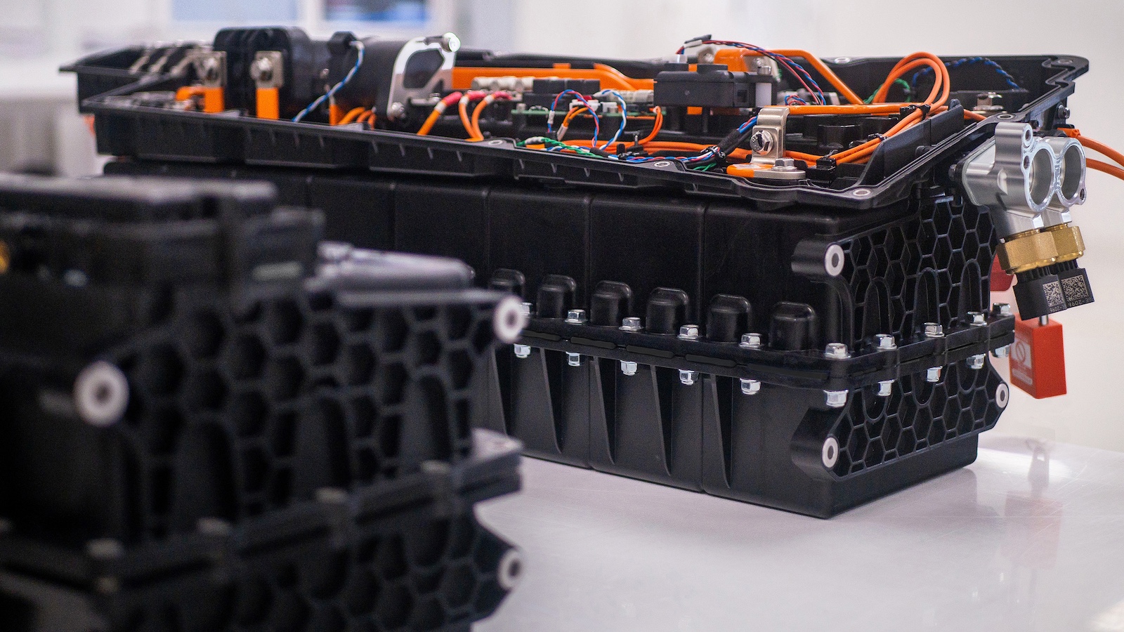

EV battery cooling system
Image courtesy of BASF

Battery cooling is an essential component of design for reasons of both safety and performance, particularly for high-performance EVs where liquid cooling using a water/glycol mixture is common. In one such vehicle, a hypercar from RML Group, BASF supported development of a cooling system based on PA 6 pipes (pictured above as the feature image). PA was also used in the battery housing and individual battery cell holders.
