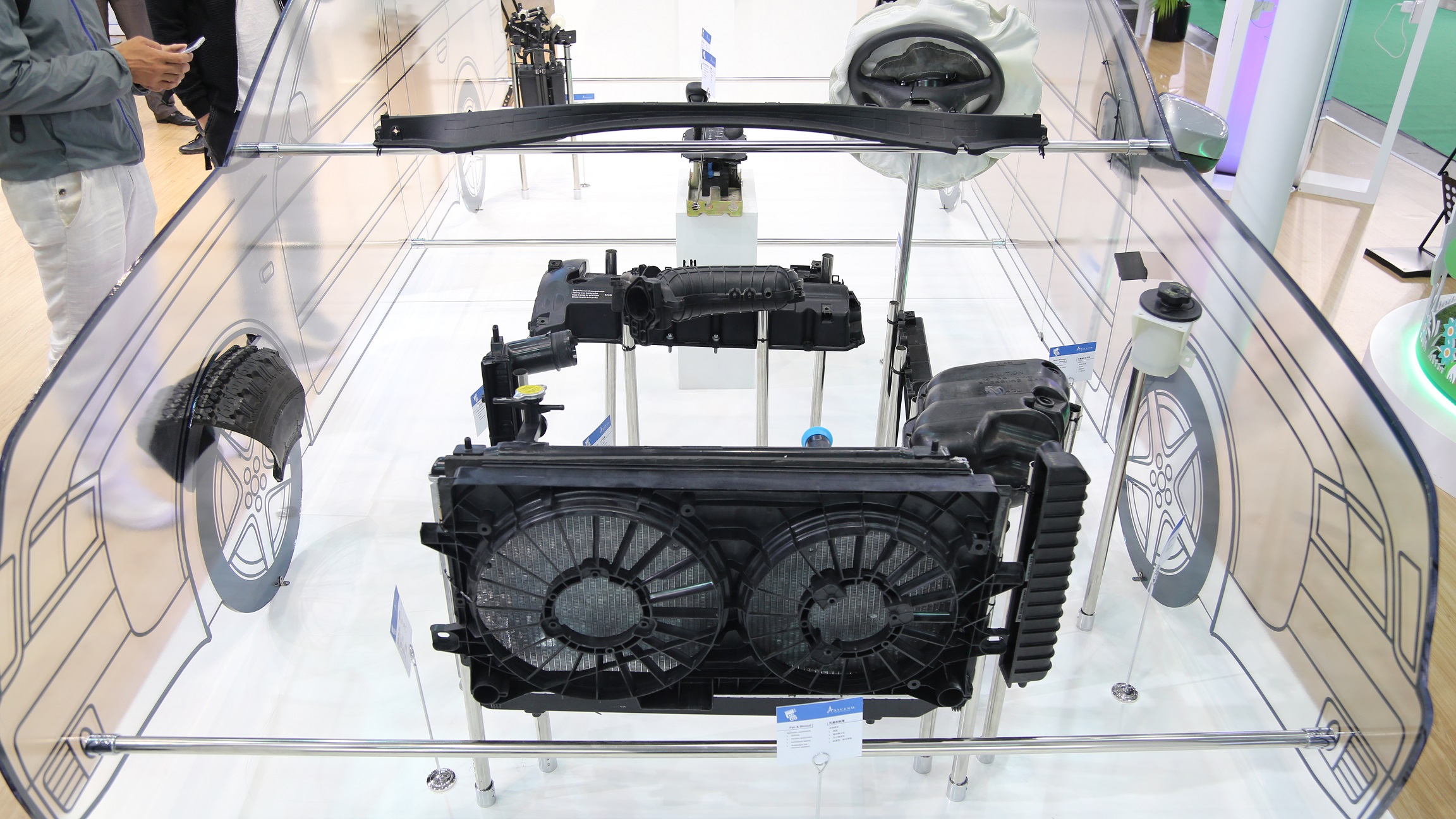

The recent Chinaplas show in Shanghai highlighted numerous current and emerging auto industry trends requiring high-performance engineering plastic solutions. The importance of improving power train efficiency stood out in particular.
Power train improvements will contribute to 70% of the fuel economy gains stipulated by CAFE regulations that will be introduced in 2025, according to Philip J. Jeszke, Global Auto Segment Leader, Plastics, at Ascend Performance Materials. “The regulations require fuel economy of 54.5 mpg versus the current 34.5 mpg, and we’re only two development cycles away from this milestone,” he warns, highlighting the urgency of the task at hand.
Ascend’s Jeszke: Hydrolysis-resistant PA grades also have a role to play in radiator end tanks and other under-the-hood applications. Our Vydyne HR grades target such applications.
