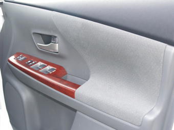

Moresco hot melt adhesive also find use in auto interiors.

The solvent-free Moresco-Melt RO series is used for adhesion of door trim It is a reactive hot melt adhesive that cures through the moisture content in the air or the material to be adhered. It exhibits high adhesive properties and heat resistance for polypropylene (PP) parts.
