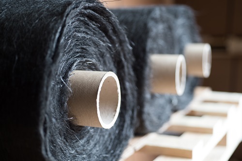

ELG Carbon Fibre (West Midlands, UK), a market leader in recycled carbon fiber materials, has commenced production of a range of nonwoven mats on a new production line which is specifically designed to process recycled carbon fibers. The mats are available in widths up to 2.7 meters at a wide range of fiber areal weights. ELG Carbon Fibre believes the materials will strongly appeal to OEMs in the transportation sector seeking cost effective alternatives to virgin carbon fiber for vehicle lightweighting.
The new machine has been custom built to ELG Carbon Fibre’s exacting specifications. Designed and manufactured in the UK, it can produce a variety of nonwoven materials including 100% recycled carbon fiber mats and thermoplastic blends such as carbon fiber mixed with PP, PA, PPS fibers.
Recycled carbon fiber nonwoven mats can be used for the manufacture of intermediate products such as prepregs and sheet molding compounds.
The Carbiso M and TM product ranges that the carbon fiber mats and blends are sold under demonstrate excellent drapability and performance whilst delivering cost effective light weighting and significant environmental benefits compared to virgin carbon fiber. The materials may be used either on their own or with selective use of virgin carbon fibers to provide tailored structural properties.
ELG Carbon Fibre’s Carbiso M mats are ideally suited for closed mold processes and can also be used for the manufacture of intermediate products such as prepregs and sheet molding compounds for composite manufacturing. The thermoplastic Carbiso TM mats are designed for fast cycle times in press molding applications.
