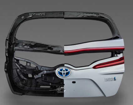

Rear door frame of the new Prius plug-in hybrid vehicle features an all CFRP construction.
SMC developed by Mitsubishi Rayon (MRC) is a type of intermediate material for CFRPs and a sheet-shaped material in which carbon fibers cut into several-centimeter lengths are dispersed in resin. The SMC can be processed into components in a short period of time, roughly 2–5 minutes, by press molding. In contrast to prepregs (uncut carbon fiber fabric impregnated with resin), this SMC features high formability for molding complicated shaped parts. It also exhibits close-to-uniform mechanical properties. This allows engineers to readily use the carbon fiber material by utilizing existing parts design know-how and achieve lighter components with higher strength.
