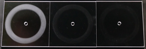

PC resin surface after abrasion test (1000 rounds) Left without hard-coat, middle employing wet-method coating, and right utilizing plasma CVD method.

In March, Teijin developed a new plasma enhanced chemical vapor deposition (plasma CVD) hard-coating technology to the wet hard-coat layer, which offers the same level of abrasion resistance and weather resistance as glass windows. The company collaborated with Tsukishima Kikai Co. to develop a plasma CVD pilot plant to treat large PC-resin windows with uniform coatings of plasma CVD. Large surfaces including the size of actual vehicle’s resin windows and those with complex curves are now being glazed at the pilot plant.
